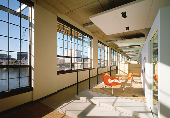

Not that long ago, it took some doing to convince a building owner to pay for even low-cost energy-saving measures. Many factors have converged to produce a very different situation today. Consequently, installing an energy management system (EMS) is often part of a building construction or renovation project. A few simple strategies for reducing energy waste with an EMS can reap big savings (Photo 1).
Photo 1. HGA Architects and Engineers not only designs EMS applications, but also uses them in its own offices. For example, the HGA Milwaukee office uses automated strategies for HVAC control, automated lighting, and daylight harvesting (Photo courtesy of HGA Architects and Engineers).

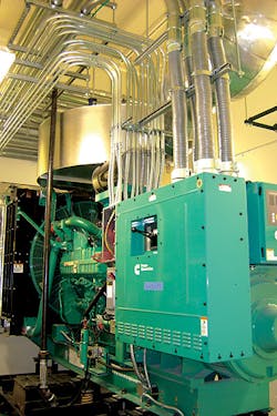

• Peak shaving. Control specific loads to avoid peak usage penalties. For example, the system might do the following during peak load hours: dim warehouse lighting, lock scrap grinders out of use, lock garbage compactors out of use, adjust some thermostats by a few degrees, and lock out specific chillers entirely. Or, it may run the generator so all loads are still available to operations (Photo 3).
Photo 3. Using an EMS to remove some loads is one strategy for peak shaving, but that can impair operations. Another is to kick in a generator to reduce the amount of load supplied by the utility so that operations aren’t affected by peak shaving (Photo courtesy of HGA Architects and Engineers).
