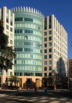

Photo 1. Emergency power systems help prevent additional emergencies when hospitals lose power (Paulbr/iStock/Thinkstock).
Emergency systems serve a specific function. They protect human life by providing the essential power and illumination [700.1] for egress and for the operation of emergency-related equipment, such as ventilation, fire pumps, and communication systems. For this reason, you find them at hospitals (Photo 1  and Photo 2).
Photo 2. Emergency power makes it possible to safely evacuate large, multi-story medical centers and other high-occupancy facilities.
