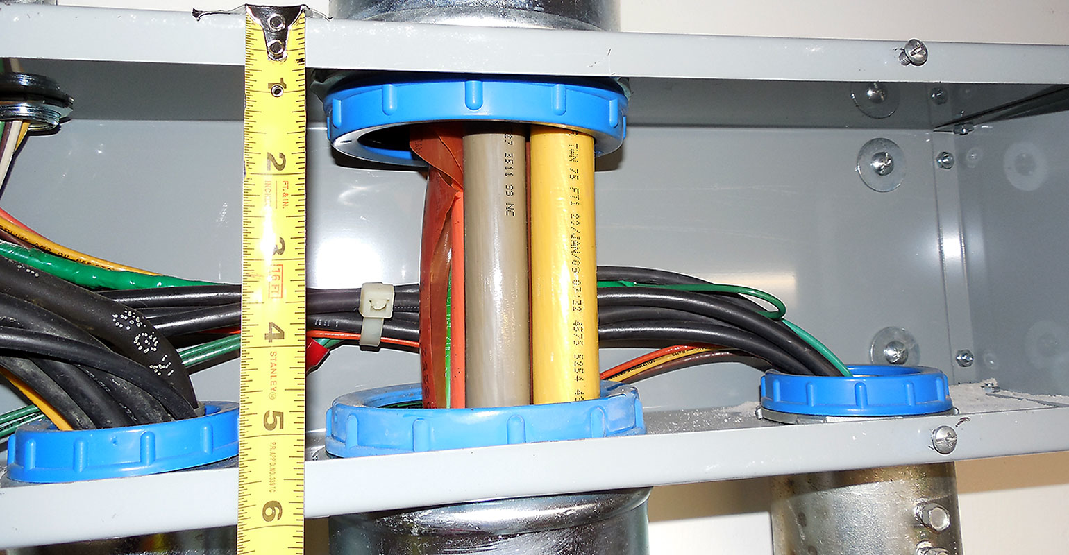

Wrong Way Wireway
Although you probably can’t see it, there’s a 4-in. stamp on the top EMT connector. The conductors inside the EMT are 600kcmil THWN. Obviously, the installer ignored both of these dimensions when choosing and installing this wireway.
There are a couple of options for sizing wireways. When insulated conductors are deflected in the wireway, or where raceways enter or leave the wireway, Sec. 376.23(A) requires dimensions based on Column 1 from Table 312.6(A). For the 600kcmil wires installed here, 8 in. would be needed between the conductor’s entry and the opposite wall. Where wireways are used as pull boxes, Sec. 376.23(B) requires dimensions corresponding to Sec. 314.28(A)(1) for straight pulls and Sec. 314.28(A)(2) for angle pulls. For this straight pull, a dimension of (8 in. × 4 in.) 32 in. would be required. This installer has only provided a 6-in. wireway.
You may need to have a discussion with your AHJ to determine what constitutes “using a wireway as a pull box” because there are no clear-cut guidelines provided in the Code, and it makes a huge difference. It appears this installer never had those discussions.
