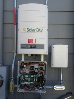

In this installation, the inverter charge controller is separate from the storage system.

I believe the response provided by UL to the initial question, based on the 2017 NEC, should be open for further discussion as it really depends on the equipment and its installation instructions, as well as its listing for the intended application.
The 2017 NEC clearly allows field construction of multiple listed components for these systems. However, that changed in the 2020 NEC based on a Public Comment (PC) #1572 submitted by a representative from a testing laboratory. The change mandates that all ESSs must be listed as a system and removes the option to field-assemble listed components from different manufacturers unless those components have been submitted as an assembly for testing to the requirements set forth in UL 9540.
