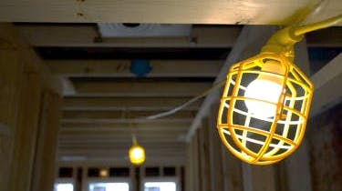

Installation rules for branch circuits and receptacles
All branch circuits shall originate in an approved switchgear, panelboard, switchboard, power outlet, motor control center, and fused switch enclosure. And keep in mind the branch circuit exception located in Sec. 590.4(C)(2). Where the wiring is installed in accordance with 590.3(B):
  • The voltage to ground shall not exceed 150V.
  • The wiring shall not be subject to physical damage; it shall be protected per Sec. 590.4(H). Flexible cords and cables shall be protected from accidental damage. Sharp corners and projections shall be avoided. Where passing through doorways or other pinch points, protection shall be provided to prevent damage.
  • The conductors shall be supported on insulators at intervals of not more than 10 ft; for festoon lighting, the conductors shall be so arranged that excessive strain is not transmitted to the lampholders.
