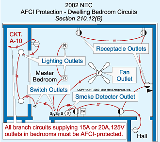

New Code requirements.
In 210.12(A), the 2002 NEC defines an AFCI as “a device intended to provide protection from the effects of arc faults by recognizing characteristics unique to arcing and by functioning to de-energize the circuit when an arc fault is detected.” Also note the new wording of 210.12(B). Before, all branch circuits that supplied 125V, single-phase, 15A and 20A receptacle outlets installed in dwelling unit bedrooms had to be protected by an AFCI. Now, AFCIs that protect outlets in dwelling unit bedrooms must be listed to provide protection of the entire branch circuit. (Figure above.)
Because this requirement applies to 125V outlets, AFCI protection isn't required on a 240V circuit serving a baseboard heater or room air conditioner. In addition, a new subsection (B) added to 550.25 requires AFCI protection for all branch circuits that supply 15A and 20A, 125V outlets in bedrooms of mobile homes and manufactured homes.
Muddying the waters is the conflict between circuit breaker manufacturers and wiring device manufacturers that make listed AFCI devices. Circuit breaker manufacturers insist the only acceptable device is the AFCI circuit breaker, but wiring device manufacturers take the position that AFCI receptacles listed to protect the entire branch circuit are equally suited and Code-compliant.
However, the Code has the final say. An AFCI protection device must de-energize and protect the entire circuit from an arc fault. The only device that can do this is an AFCI circuit breaker. Because AFCI receptacle types listed to detect upstream series arc faults will not de-energize the circuit from parallel-type arc faults that may occur upstream of the device, they don't meet the requirement set forth in 210.12.
