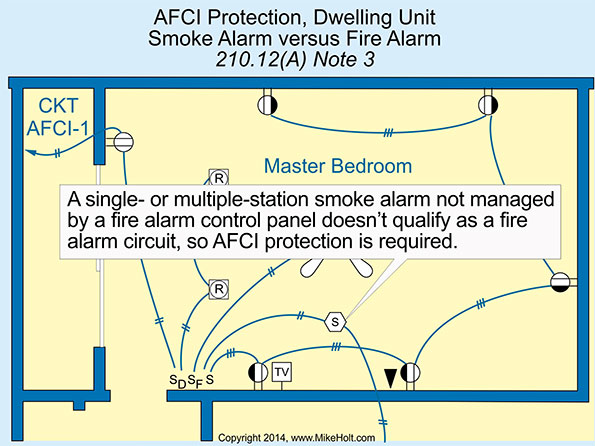

Author’s Comment: Smoke alarms connected to a 15A or 20A circuit in a dwelling unit must be AFCI protected if the smoke alarm is located in one of the areas specified in Sec. 210.12(A). The exemption from AFCI protection for the “fire alarm circuit” contained in Sec. 760.41(B) and Sec. 760.121(B) doesn’t apply to the single- or multiple-station smoke alarm circuit typically installed in dwelling unit bedroom areas. This is because a smoke alarm circuit isn’t a fire alarm circuit as defined in NFPA 72, National Fire Alarm Code. Unlike single- or multiple-station smoke alarms, fire alarm systems are managed by a fire alarm control panel.
