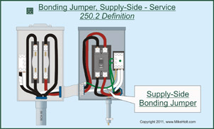

One of the revisions to the 2011 NEC involves a new definition for a common term: bonding jumper, supply-side. A supply side bonding jumper is a conductor on the supply side or within a service or separately derived system to ensure the electrical conductivity between metal parts required to be electrically connected (Fig. 1).
The method used to size bonding jumpers depends on their location in the circuit, which can be a point of confusion. Generally speaking, if bonding conductors are:
  1. On the load side of the service main overcurrent device, they are sized according to Table 250.122, based on the rating of the overcurrent device.
  2. On the supply side of a service main overcurrent device or ahead of the overcurrent protection device on the secondary of a separately derived system, they are sized using Table 250.66 and the 12.5% rule in 250.102(C).
Fig. 1. A supply-side bonding jumper is a conductor on the supply side or within a service to ensure the electrical conductivity between metal parts required to be electrically connected.
