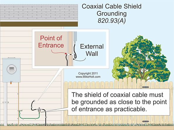

Fig. 1. You must ground the metallic sheath of the coaxial CATV cables entering the building.
Coaxial CATV cables entering the building or terminating on the outside must have the metallic sheath members grounded per 820.100 (see Fig. 1).

For all other situations, the outer conductive shield of a coaxial cable must be bonded or grounded as follows [820.100].
The bonding conductor or grounding electrode conductor must be:
• Listed (insulated, covered, or bare).
• Copper or other corrosion-resistant conductive material (stranded or solid).
• At least 14 AWG with a current-carrying capacity of not less than the grounded metallic sheath member (or protected conductor of the communications cable); not required to be larger than 6 AWG.
• Run in as straight a line as practicable.
• Mechanically protected where subject to physical damage. Where installed in a metal raceway, each end of the raceway must be bonded to the bonding conductor or GEC.
• As short as practicable. For one- and two-family dwellings, the bonding conductor or GEC must not exceed
20 ft. If this limit isn’t practicable, install separate ground rod at least 8 ft long, with fittings suitable for the application [250.70 and 820.100(C)]; bond it to the power grounding electrode system with a minimum 6 AWG conductor [820.100(D)].
