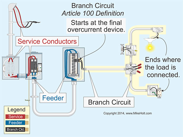

A branch circuit consists of the conductors between the final overcurrent protection device (OCPD) and the point of use outlets [Art. 100] (Fig. 1). Article 210 contains requirements for installing these circuits.
Specific-purpose branch circuits (identified in Table 210.2) have additional requirements [210.2]. These amend or supplement the provisions given in Art. 210, so it’s important to check the application against Table 210.2. Note that Art. 210 doesn’t apply to circuits that supply only motor loads [210.1]. Although much of Art. 210 addresses residential applications, our focus here is on industrial and commercial applications.
Fig. 1. A branch circuit is defined as the conductors between the final overcurrent device and the outlet(s).
