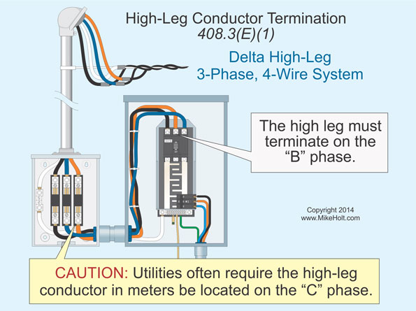

High-leg
Panelboards supplied by a 4-wire, delta-connected, 3-phase (high-leg) system must have the high-leg conductor (which operates at 208V to ground) terminate to the “B” (center) phase of the panelboard [408.3(E)]. There’s an exception to this rule. Namely, the high-leg conductor can terminate to the “C” phase when the meter is in the same section of a switchboard or panelboard. And some cautions apply:
• Orange identification, or some other effective means, is required for the high-leg conductor [110.15 and 230.56].
• The ANSI standard for meter equipment requires the high-leg conductor (208V to neutral) to terminate on the “C” (right) phase of the meter socket enclosure. This is because the demand meter needs 120V, and it gets it from the “B” phase (Fig. 1).
• When replacing equipment in existing facilities that contain a high-leg conductor, put the high-leg conductor back in its original location. Prior to 1975, the high-leg conductor was required to terminate on the “C” phase of panelboards and switchboards. Failure to re-terminate the high leg where it came from can result in 120V circuits being inadvertently connected to the 208V high leg. Such a connection will almost certainly be disastrous.
