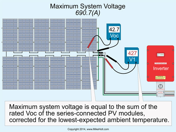

The maximum PV system voltage for a DC circuit is equal to the rated open-circuit voltage (Voc) of the series-connected PV modules, as corrected for the lowest expected ambient temperature [690.7]. You use this voltage to determine the voltage rating of conductors and equipment for the DC circuits (Fig. 1).
Voc is the voltage when there’s no load on the system. When Voc temperature coefficients are supplied by the manufacturer as part of the installation instructions for listed PV modules, you must use these values to calculate the maximum PV system voltage (instead of using Table 690.7), as required by Sec. 110.3(B).
One source for lowest-expected ambient temperature is the Extreme Annual Mean Minimum Design Dry Bulb Temperature found in the ASHRAE Handbook — Fundamentals. See www.solarabcs.org/permitting/map.
PV module voltage has an inverse relationship with temperature. At lower temperatures, the PV modules’ voltage increases from the manufacturer’s nameplate Voc values. At higher temperatures, the PV modules’ voltage decreases from these values.

You have several ways to determine the PV system voltage. One way is to base it on the Manufacturer Temperature Coefficient %/°C.
Example: Using the Manufacturer Temperature Coefficient of -0.36%/°C, what’s the maximum PV source circuit voltage for 12 modules each rated Voc 38.30 at a temperature of -7°C?
PV Voc = Rated Voc × {1 + [(Temp. ºC - 25°C) × Module Coefficient %/°C]} × # Modules per Series String
Module Voc = 38.30 Voc × {1+ [(-7°C - 25°C) × -0.36%/°C]}
Module Voc = 38.30 Voc × {1 + [-32°C × -0.36%/°C]}
Module Voc = 38.30 Voc × {1 + 11.52%}
Module Voc = 38.30 Voc × 1.1152
Module Voc = 42.71V
PV Voltage = 42.71V × 12 = 513V
