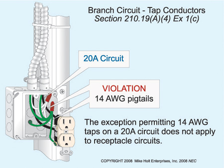

Can I use 14 AWG conductor pigtails from a 12 AWG, 20A circuit so that I can backstab the wires to the receptacle?
June 19, 2008
Q. Can I use 14 AWG conductor pigtails from a 12 AWG, 20A circuit so that I can backstab the wires to the receptacle?
A. No. Branch circuit tap conductors are not permitted for receptacle outlets [210.19(A)(4) Ex No.1 (c)].
