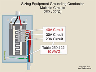

Q. What is the sizing rule for an equipment grounding conductor in a raceway that contains multiple circuits?
A. When multiple circuits are installed in the same raceway, cable, or cable tray, only one equipment grounding conductor is required for the multiple circuits, sized in accordance with 250.122, based on the rating of the largest circuit overcurrent device [250.122(C)]. Single conductors used as equipment grounding conductors in cable trays must be sized 4 AWG or larger [392.3(B)(1)(c)], as shown in the Figure.
