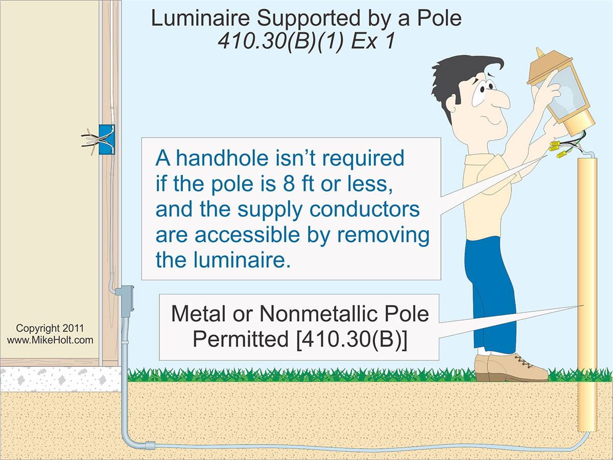

A. A pole can be used to support luminaires and serve as a raceway [410.30]. However, they must comply with the following six requirements:
1) The pole must have an accessible 2 in. x 4 in. handhole with a cover suitable for use in wet locations that provides access to the supply conductors within the pole. There are two exceptions to this rule.
Exception No. 1: The handhole isn’t required for a pole that’s 8 ft or less in height, if the supply conductors for the luminaire are accessible by removing the luminaire (see Figure).
