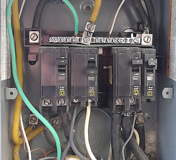

This Service Needs Servicing
A big thank you goes out to Peter Argyropoulos of Petros Electric for sharing these photos with us. He found this installation in rural Pennsylvania.
According to Argyropoulos, “This service feeds a dwelling as well as a large mechanic’s shop where they do welding, tire replacements, etc. The female cord end sticking out of the disconnect box is the generator hookup. There is a suicide cord that the generator installer made for the hookup.”
Backfeeding an attachment plug in this manner is a violation of Sec. 406.7(B).  Prongs of attachment plugs must not be energized unless inserted into an energized receptacle or cord connector.
Argyropoulos adds, “The individual 2/0 aluminum feeders coming out of the white PVC at ground level, which enter the enclosure via separate ½-in. KOs, feed the mechanic’s shop.” These wires violate the requirements of Sec. 300.3(A) because single conductors must be installed in a Chapter 3 wiring method. They also violate Sec. 300.20(B), since no slots were cut between the individual openings.
“The issue I was called out for is that the generator breaker tripped every time they tried to connect it to power the house,” explains Argyropoulos. “I’d say the linemen were very lucky it did.” Section 702.5 requires transfer equipment to be used for this generator hookup.
