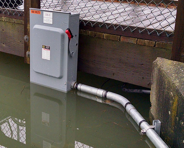

Wow! What a scary situation. This “ugly picture” was published in the June 2016 issue of the Washington State Dept. of Labor and Industries newsletter “Electrical Currents.” According to the newsletter, “This disconnect switch is attached to a fixed pier. NEC 555.9 requires all electrical connections to be located at least 12 in. above the deck of a fixed pier but not below the electrical datum plane as defined in 555.2.” The datum plane for areas with tidal fluctuations is a horizontal plane 2 ft above the normal highest tide. For areas without tidal fluctuations, the datum plane is a horizontal plane 2 ft above the highest normal water level. This 480V disconnect switch has been installed in a terrible location, creating a perilous shock hazard. The water surrounding this disconnect, as well as the wet pier itself, could become energized if the water comes in contact with the energized parts inside of the disconnect. I’m not sure this disconnect switch would be considered readily accessible either as required by Sec. 404.8(A). I also don’t think the location of this disconnect will “prevent moisture or water from entering and accumulating within the cabinet” as required by Sec. 404.4(A) and Sec. 312.2.
