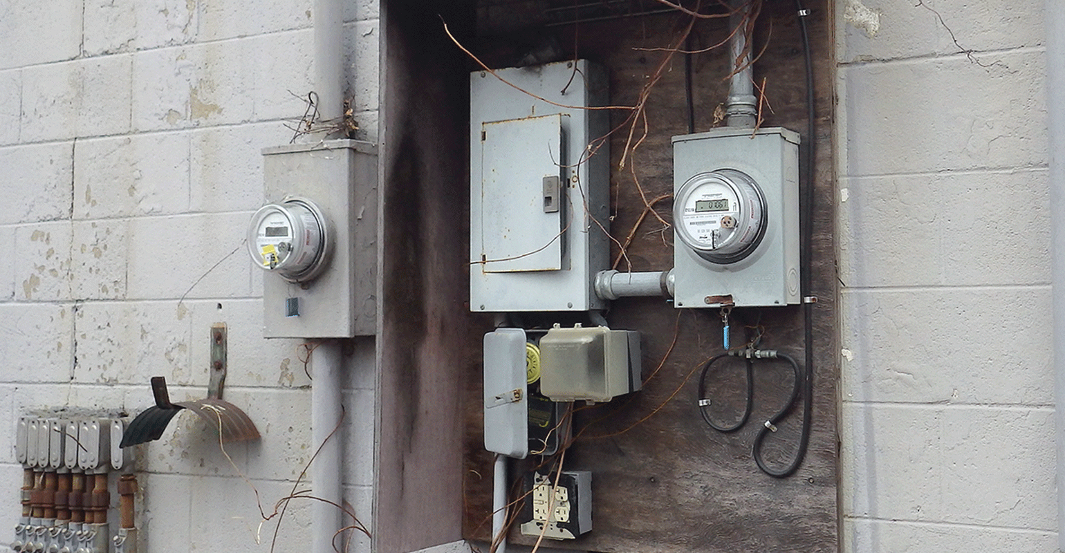

I spotted this disaster while driving by a vehicle service station. Of course, I immediately parked my car, and jumped out to take a few pictures. It appears there once was some type of wooden “doghouse” type of enclosure built around this equipment to provide some protection from the weather. The deteriorated remnants of the enclosure have left this equipment exposed to the elements, which offers up a variety of violations.
The panelboard enclosure is not suited for use in a wet location as specified in Sec. 312.2. It is now subjecting the equipment to rain and moisture. Wet circuit breakers and bus bars could create a dangerous situation. Section 110.28 provides choices for selecting the correct type of enclosure for specific locations. For example, a Type 3R enclosure might be a good choice for this situation.
The receptacles located below the panelboard are also exposed directly to the weather because the box cover is broken off. This is a violation of Sec. 406.9(B)(1), which requires a complete weatherproof enclosure be installed to protect these receptacles even while equipment is plugged in. An outlet box hood for this receptacle box would need to be rated as “extra duty” type.
