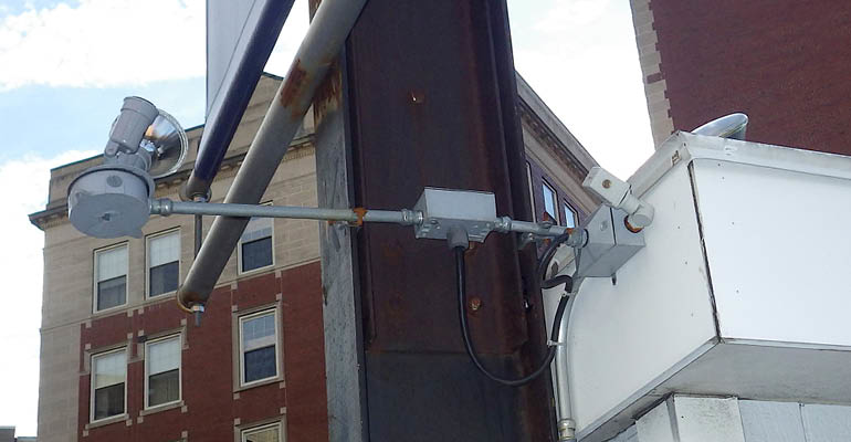

Floodlight Installation Failure
The round weatherproof box installed at the end of this conduit is not properly supported. Using rigid metal conduit (RMC) to support a box is permitted under very specific conditions, but this installer did not follow those rules.
The general rule in Sec. 314.23(F) permits the use of two RMCs or intermediate metal conduits (IMCs) threaded wrenchtight into the enclosure to support a box not greater than 100 cu in. The conduits then need to be secured within 18 in. of the box. This box only has one conduit supporting it, in addition to having a compression fitting threaded into the box instead of having the conduit threaded directly into the box. Perhaps the installer was trying to take advantage of Exception No. 2 in Sec. 314.23(F) for this installation. That exception allows a single RMC to be used to support a box or conduit body if six conditions are met. This installation does not meet all those conditions. A focused read of Condition 6 for the exception reveals the problem again. The RMC must be threaded wrenchtight directly into the box without the use of a compression connector. On another topic, the use of flexible cord between the two boxes on the right could be considered a violation of Sec. 400.12(1).
