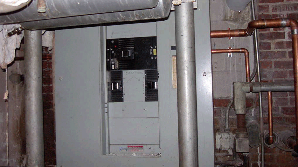

This Drives Me Plumb Crazy
As you can see by this photo, plumbers and electricians are still waging a never-ending battle for space. I don’t know who was here first, but the result is an installation with no clear working space as required by Sec. 110.26(A). For equipment such as switchboards, panelboards, and other equipment likely to be examined, adjusted, serviced, or maintained while energized, Sec. 110.26(A)(1) requires a minimum working space depth ranging from 3 ft to 5 ft, depending on conditions and voltage. The minimum width of the working space required by Sec. 110.26(A)(2) is 30 in., or the width of the equipment, whichever is greater. The minimum height required by Sec. 110.26(A)(3) for the working space extends from the floor, grade, or platform to a height of 6½ ft or the height of the equipment, whichever is greater. Working in crowded and cramped conditions such as this greatly increases the danger of the already hazardous job of working on energized electrical equipment. Building owners and managers need to recognize this threat and coordinate with all the building trades in an effort to prevent situations such as this from arising on their property.
