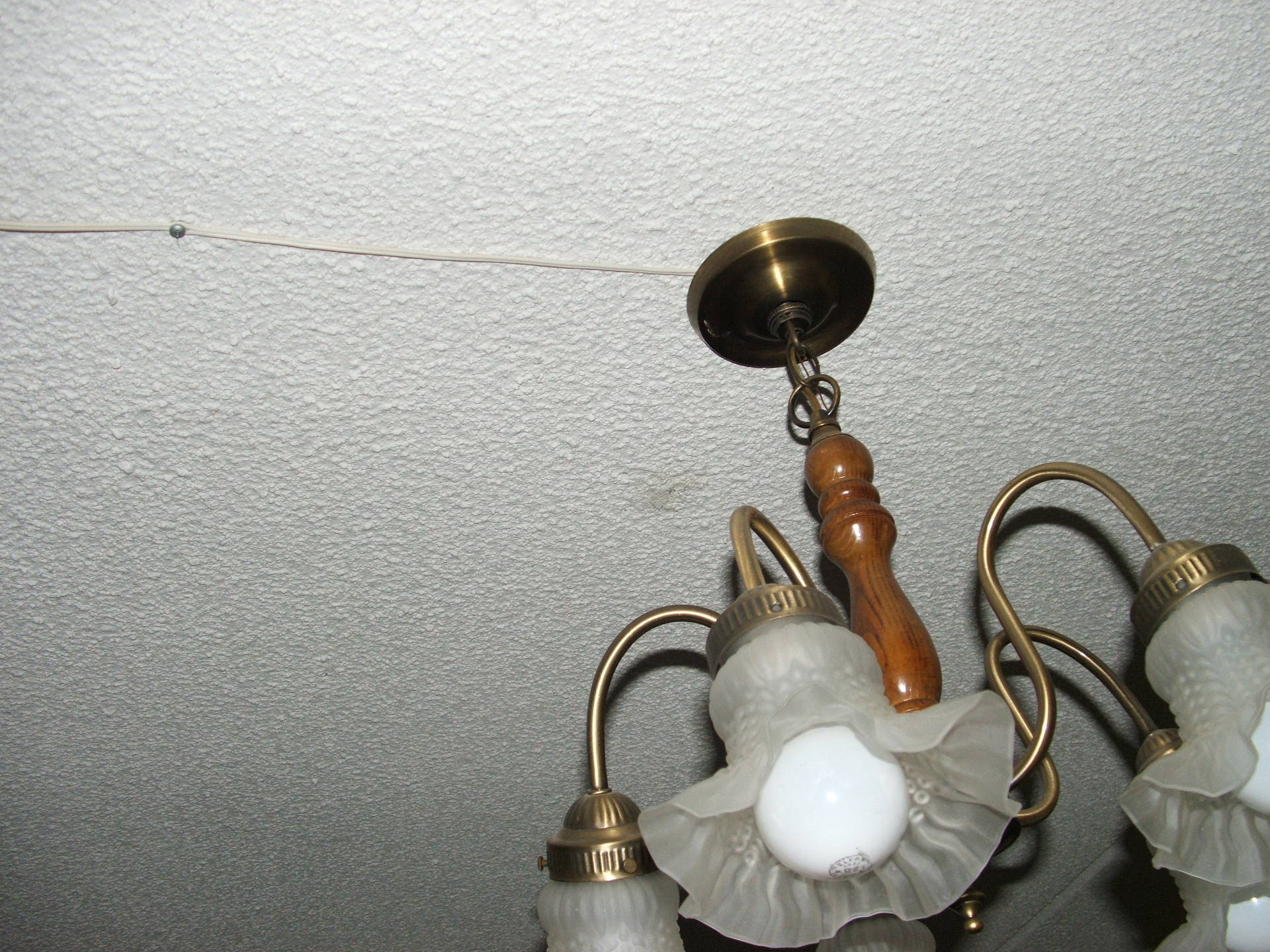

These two photos show what I found when the maintenance manager for an apartment building called me to check out some curious wiring he found inside one of the apartments. The tenant had apparently taken matters into his own hands when installing a chandelier over his dining table. The tenant bought some 2-wire, flexible lamp cord at the local hardware store and used that for wiring the chandelier. He anchored the flexible cord and the chandelier directly to the concrete ceiling using anchors. If you look closely, you can see that the anchors are installed between the two conductors of the cord and are pinching the cord to the ceiling. Amazingly, it never short-circuited. The other end of the cord was snaked down a sheetrock wall and connected to a receptacle using a cord cap. Using a flexible cord in this manner violates several list items of Sec. 400.12, including (1), (4), and (5). The other huge problem is the lack of bonding and grounding of this luminaire. Section 410.42 requires exposed conductive surfaces of this luminaire to be connected to an equipment grounding conductor.
