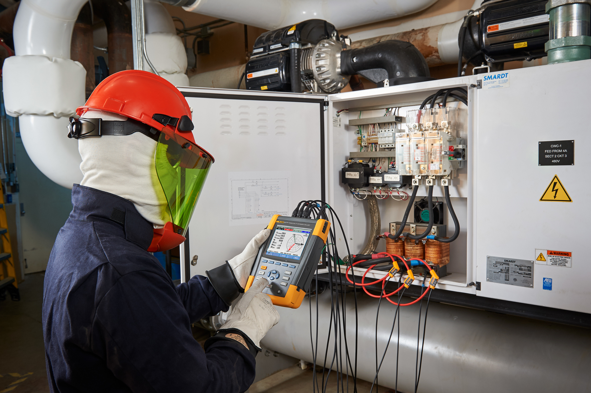

The stability of an electrical system can be described as “power quality health.” The first step to evaluating an electrical system’s health is to capture data from equipment, infrastructure, and the service panel. This is measured on 3-phase electrical systems using instrumentation that considers several variables.

Installation of filters can be very effective economically and technically, depending on the source of the harmonic distortion. To discover the specific source(s) requires harmonic surveys of the equipment connected to the system. A good place to start is with the largest electronic drives — consider which equipment draws the highest current, such as large drives or high-power UPS systems, to find out which ones have the highest THD present. Collect as much harmonic data as possible over a few days to see how the THD changes and identify the worst-case scenarios. This data can then be shared with a filter supplier who can advise on suitable solutions per load. It may only be one or two pieces of equipment that are causing the problem. The worst case is that you need a larger system, but, once again, a supplier can advise on a suitable solution.
Replacing transformers is more difficult. It still requires harmonic surveys to discover K-factor — the heating effect due to harmonics. The K-factor is derived from the harmonics using an IEEE recommended method; however, a suitable instrument calculates this for you. K-factor-rated transformers are more expensive than standard transformers and downtime for installation of a new transformer can prove disruptive and create significant downtime. However, in some cases, this might be the only viable solution.
