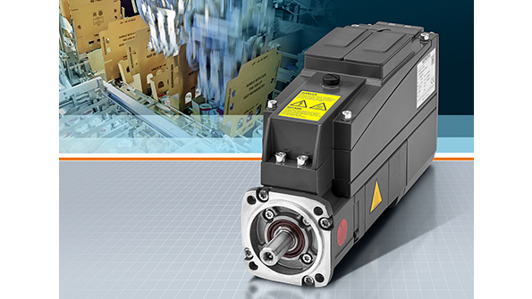

Offers option of moving motor inverter outside control cabinet and directly onto motor Pre-assembled hybrid cable contains all encoder and power cables Optional holding brake
The Sinamics S120M is a compact, ready-to-connect motor with integrated drive that offers users the option of moving the motor inverter outside the control cabinet and directly onto the motor, reducing cabinet space and required cooling. The decentralized S120M axes are connected back to the central S120 components in the cabinet via a hybrid cable and the AM600 adapter module. The pre-assembled hybrid cable contains all encoder and power cables and serves multiple S120M axes through a daisy chain connection. Additional features include a synchronous servomotor with multi-turn absolute encoder, optional holding brake, and an integrated power unit (motor module) available in three shaft heights covering the power range of 0.25kW to 1.5 kW.
