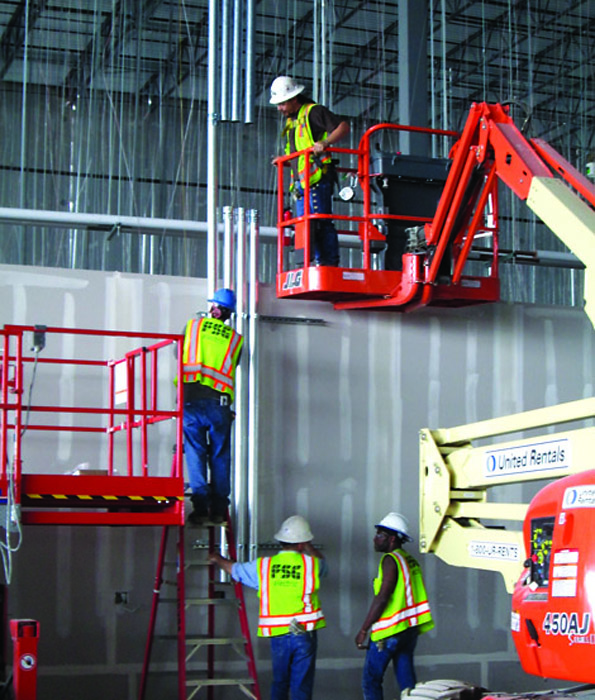

Other obstacles included a roof deck height of 40 ft, which required much of the electrical installation to be performed on 45-ft manlifts — necessitating as many as 40 lifts on-site at one time — along with a lack of power.
“Temporary or permanent power wasn’t available on-site until the end of May,” notes Garrett. “We fed the building and our trailer compound with a 500kW generator that ran 24/7.”
