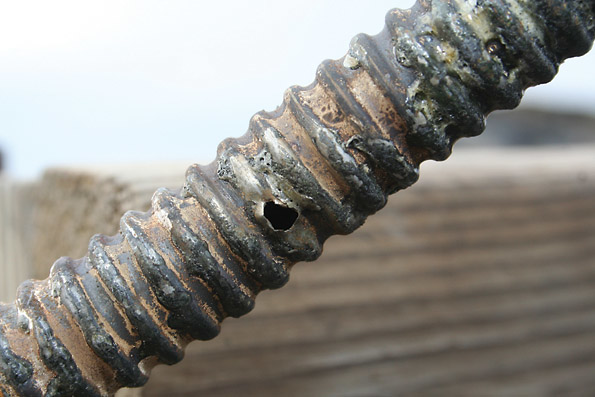

When a plumbing contractor installed flexible corrugated stainless steel tubing (CSST) in a livestock barn in order to supply propane to ceiling-mounted heaters, he had no reason to envision the tragedy that would ultimately unfold. Little did he know that three years later, a high-voltage electric utility wiring short circuit nearby (approximately 500 ft from the barn) would cause the tubing to perforate and ignite combustibles in the ceiling area of the barn, starting a fire that resulted in total loss of the building as well as the livestock inside.
Photo 1. Note the perforation in this section of CSST. This tubing ran to a heater in the southwest area of the barn.
When a truck veered off the right side of a two-lane road and struck a wood utility pole in an attempt to avoid a vehicle stopped in the roadway, the damage resulted in a 7,200V overhead wire falling to the ground and coming in contact with the electric utility neutral wire. Moments later, an individual turning left onto the farm driveway noticed smoke coming from the barn. He immediately ran to the structure and observed flames coming from the CSST line on the south wall ceiling area, and quickly shut off the propane supply to the building. During the investigation that followed, a perforation in the CSST in the area of origin was identified as the cause of the fire.

The barn, featuring a pitched roof and corrugated metal walls, contained three propane heaters mounted in the ceiling area. A propane tank was located at the rear of the structure, and a copper tube extended underground to the livestock barn. The ground resistance of the copper propane tube measured 3.2 ohms. At the south rear side of the barn, the plumber converted to CSST from copper tubing and routed the CSST along the exterior of the corrugated wall to an opening near the propane overhead heater. Evidence indicates the perforation of the CSST was at a location where it routed through the corrugated wall in the southwest corner (Photo 1 and Photo 2).
Photo 2. Arrow pointing to area where perforation in CSST was discovered.

In the case of this fire, the perforation of the CSST was found at a bend in the flexible tubing, which is consistent with where it entered the barn through a hole in the corrugated metal wall. The aluminum south wall was destroyed by the fire, as was the polyethylene coating on the CSST. However, CSST was present through an opening in the north wall — where no perforation occurred (Photo 3).
Photo 3. CSST routed through the north corrugated wall of the barn showed no perforation.
Based on reference material and research from the NFPA and Los Alamos National Laboratory, the melting temperature range for 304 stainless steel used for CSST is between 2,550°F to 2,650°F, while temperatures of wood structure fires are reported to reach up to 1,880°F. Aluminum has a melting temperature of 1,220°F, while temperatures of electrical arcing are in the range of several thousand degrees Fahrenheit. This helped us derive two findings. The temperature of the fire could reach a sufficient level to melt the aluminum corrugated wall, but would not be sufficient to melt the stainless steel CSST. As a result, when a perforation of CSST occurs, it is likely that an arc has occurred that generated sufficient heat to melt the steel at that point. Potential causes for this arc are either contact with an energized wire or surface causing a short circuit condition, or a transient elevated voltage condition occurred that energized conductive surfaces near the CSST, such as a lightning strike (see Event Significance).
In this case, lightning was not detected in the vicinity of this location at or shortly prior to the fire event; therefore, it was not a probable cause. Copper has a melting temperature of approximately 1,980°F, and typically survives a structure fire. Arc mapping is the identification of the location of arcing events in the wiring system, which can be a useful method for analyzing fire origination and spread. No arcing was identified on any branch circuits in the vicinity of the area of origin, which ruled out an electrical short circuit condition with the CSST.

The manufacturer’s design and installation guide indicates that “the protective plastic jacketing should be kept in place as much as possible to protect the tubing from corrosive threats.” There is no indication that this plastic jacketing is intended to provide electrical insulation of the tubing. Although the electric utility fuse would open as a result of the short circuit condition, fuses take some time before opening. As a result, a short-duration (or transient) condition can exist on the system during the time prior to the fuse opening. My investigation concluded that the CSST arced to the corrugated metal wall at the opening when the electric utility fault occurred, with the elevated voltage causing perforation of the CSST and resulting structure fire.
