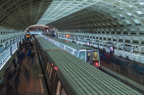

Smoke was all Patrick Adams could see when he stepped onto the platform — smoke and people stumbling and coughing as they searched the underground rail station for exits. As Adams would later tell investigators for the National Transportation and Safety Board (NTSB), the scene was nothing short of “chaotic.”
Adams is a rail supervisor for the Washington Metropolitan Area Transit Authority (WMATA). At 3:10 p.m. on Jan. 12, 2015, he was dispatched to the Washington Metro rapid transit system’s L’Enfant Plaza station after hearing reports of smoke in the tunnel. Within minutes of his arrival, smoke was so thick in the massive two-story station that Adams and first responders on the scene from Metro Police and D.C. Fire could barely see each other. But they had to evacuate, and their highest priority was getting everyone out of the two trains stopped in the tunnel just beyond the platform. Riders were so desperate to get out of the smoke-filled cars that they disembarked on the tracks and climbed up to safety. By the time the chaos subsided that afternoon, 86 passengers had been taken to area hospitals. Two were in critical condition; one was dead.
shakzu/iStock/Thinkstock
It was clear almost from the start where the smoke had originated: Nearly 16 feet of power cables feeding the train’s third rail had burned up. The affected portions of the cables were consumed in the fire. But what little evidence remained was illuminating. Investigators found copper splatter on the wall near where a cable connection would have been, and the connector and boot that should have been there were gone. The ends of the cables, according to a preliminary NTSB report, “had a melted and beaded appearance consistent with conductors that had gone through electrical arcing.” And on the cables that remained, the insulating sheathing “had been burned back and thermally damaged. This damage to the insulation varied in the degree of how far back it extended from the exposed conductor.”
