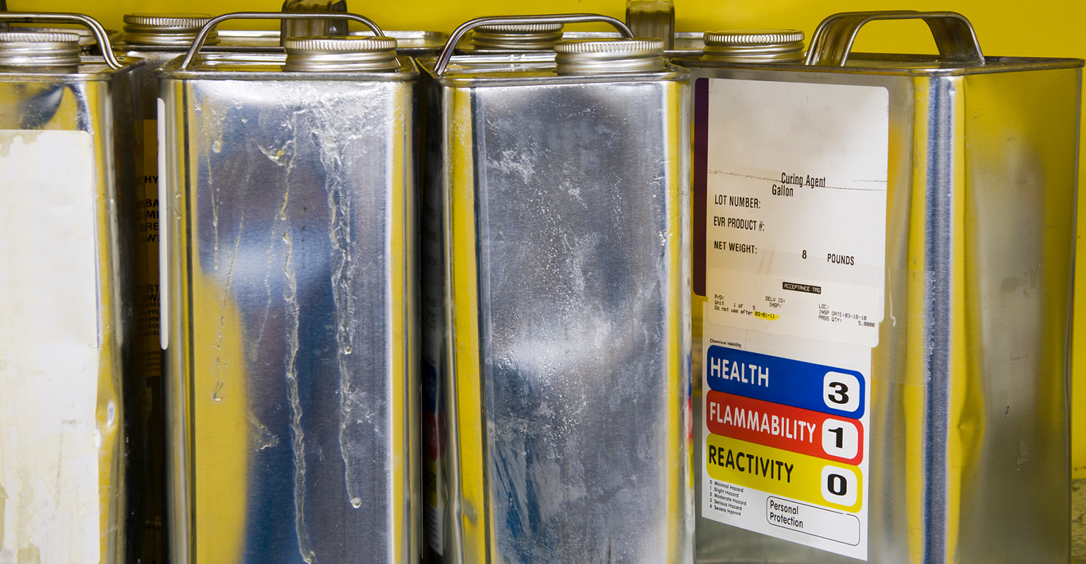

We see warning labels so much, most of us must consciously work to avoid ignoring them. That effort is worthwhile, especially when working with hazardous chemicals. Those labels aren’t there to protect the manufacturer from liability (though they help do that). A manufacturer’s legal counsel is concerned with whether the company avoids fines and civil liabilities, but OSHA isn’t. OSHA is concerned about the safety of the employee, and thus those mandated labels are there to help you protect yourself.
Labels include body-part specific information. A label may have one warning about your eyes and another about your skin.
Use the label information in your job planning. For example, what ventilation and personal protective equipment (PPE) will you need? What if it gets on your skin? The labels are usually in tiny print; you won’t have time to get a magnifier out during an emergency, so read the labels before use.
A good practice is for job planners to include the label information for each applicable chemical in each job package or work order.
