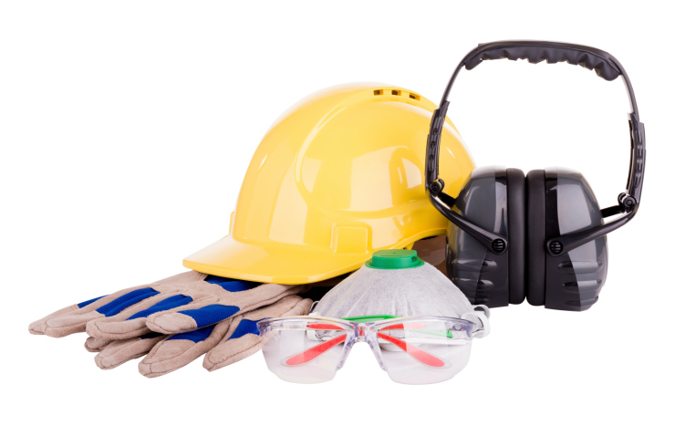

So, what are the requirements? Regardless of the PPE category, the required PPE includes:
  • Safety glasses (or, if a splash hazard, safety goggles).
  • Hearing protection
  • Hard hat
  • Leather footwear.
Looking at the requirements in Table 130.7(C)(16), you find you also need clothing with a minimum arc rating of 4 cal/cm squared. That includes a long-sleeve shirt, face shield, and other items. Plus, you need heavy-duty leather gloves.
