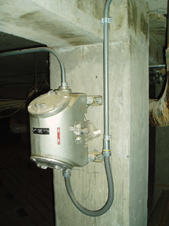

Definition of Overkill
David M. Swyter, owner of Swyter Electric in Reading, Mass., was kind enough to share this photo with us. “I could not identify a classified area within the vicinity of this equipment, but you never know,” says Swyter. “Maybe they just had money to burn — no pun intended.”
The use of this “explosionnproof apparatus” in this location seems like overkill. What good will it do since the other electrical material and fittings in this area are not of that type? The areas defined for Class I, Divisions 1 and 2 can be found in 500.5 of the Code. In addition, this definition can be found in 500.2 and Art. 100.
“Explosionproof Apparatus. Apparatus enclosed in a case that is capable of withstanding an explosion of a specified gas or vapor that may occur within it and of preventing the ignition of a specified gas or vapor surrounding the enclosure by sparks, flashes, or explosion of the gas or vapor within, and that operates at such an external temperature that a surrounding flammable atmosphere will not be ignited thereby.
“FPN: For further information, see ANSI/UL 1203-1999, Explosion-Proof and Dust-Ignition-Proof Electrical Equipment for Use in Hazardous (Classified) Locations.”
