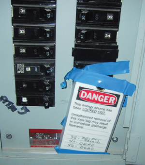

As usual, never consider the following commentary associated with these photos as a formal interpretation of the National Electrical Code (NEC). Without criticizing anyone or any product, the following scenarios present us with serious electrical safety questions. Circuit Breakers and Tape Don't Mix According to the Code, you may not use tape to lock off circuit breakers. This is an unsafe work practice
According to the Code, you may not use tape to “lock off” circuit breakers. This is an unsafe work practice that could result in a hefty fine. The rules covering this subject for a motor disconnecting means are noted in 430.102(B). When the equipment includes electric-discharge lighting systems of more than 1,000V, as in this installation, the rules of 410.81(A) and (B) also apply. Disconnection of luminaires and lamp installations must be controlled either singly, or in groups, by an externally operable switch or circuit breaker that opens all ungrounded primary conductors. Sec. 410.81(B) states, “The switch or circuit breaker shall be located within sight from the luminaires (fixtures) or lamps, or it shall be permitted elsewhere if it is provided with a means for locking in the open position.” See Art. 100 for the definition of “In Sight From (Within Sight From, Within Sight).”
