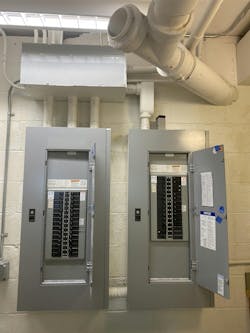

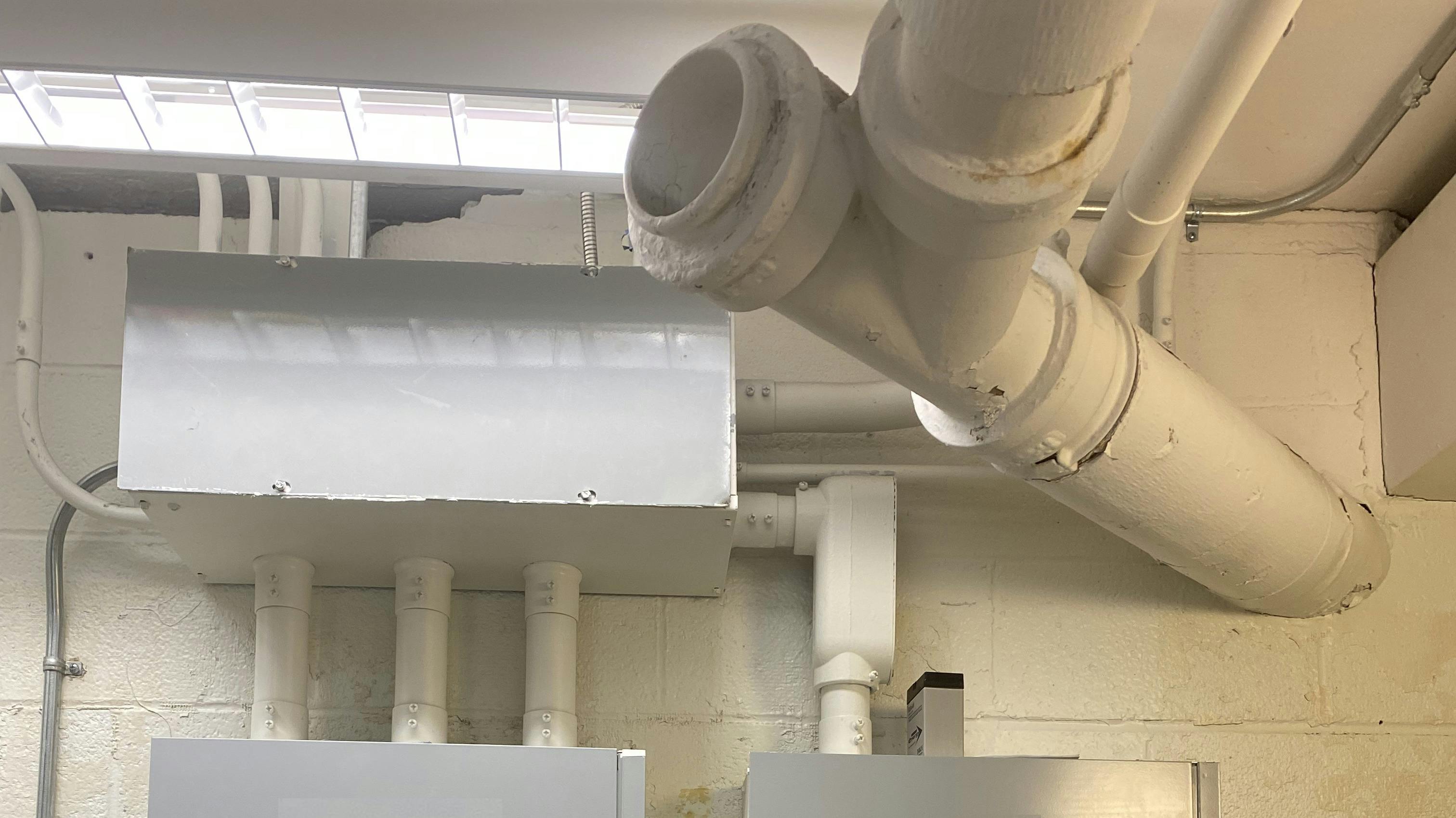

What’s Wrong Here? Hint: Bad Place for a Drainpipe
Hint: Bad place for a drainpipe.
I would not want to be near these electric panels if that sewer drainpipe above them ever leaks or needs to be cleaned out. Section 110.26(E) requires service equipment, switchboards, switchgear, motor control centers, and panelboards to be located in “dedicated space.” For indoor installations, Sec. 110.26(E)(1)(a) informs us that “dedicated space” is the space equal to the width and depth of the electrical equipment and extending from the floor to a height of 6 ft above the electrical equipment or to the structural ceiling, whichever is lower. No piping, ducts, leak protection apparatus, or other equipment foreign to the electrical installation can be installed in the dedicated space. A sewer drainpipe leaking fluids and other contaminants onto the busbars and circuit breakers of a panelboard certainly would be gross and it could also be disastrous!
