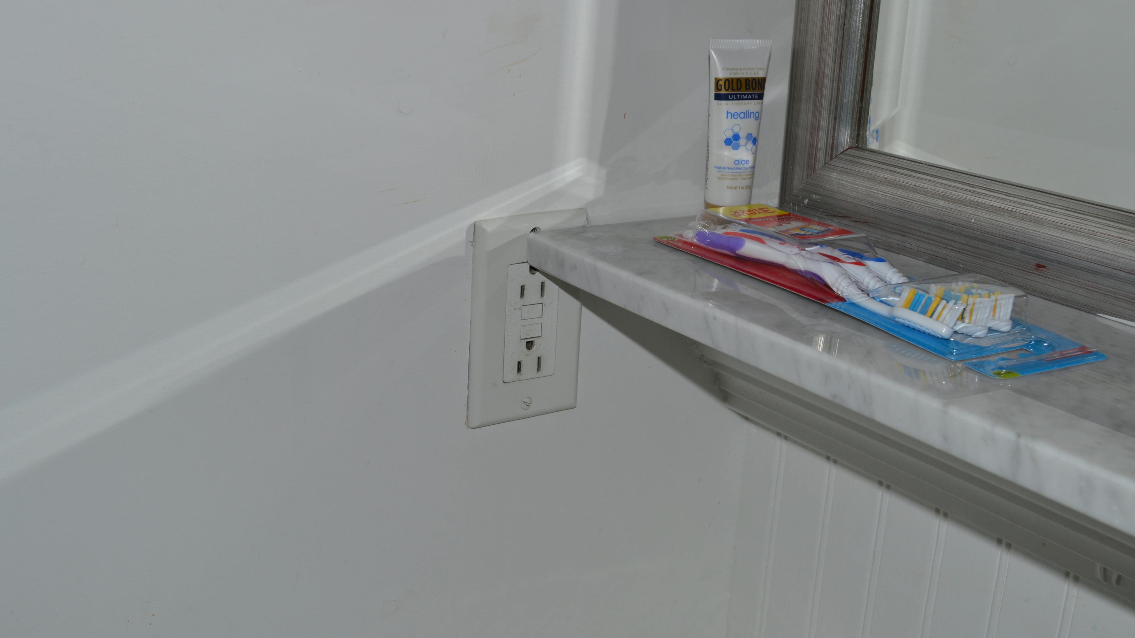

What’s Wrong Here? Hint: Access Denied
March 26, 2026
Hint: Access denied.
Removing or replacing that GFCI receptacle is going to be a tricky endeavor. The marble shelf will need to be removed in order to get that receptacle out of the box. Section 314.29(A) requires outlet boxes to be installed in a manner that the contained wiring and devices are “accessible.” Since this shelf is blocking access to this box, the box and the wiring inside the box does not meet the Art. 100 definition of accessible. Accessible wiring methods are defined as “capable of being removed or exposed without damaging the building structure or finish or not permanently closed in or blocked by the structure, other electrical equipment, other building systems, or the finish of the building.”
