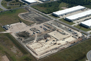

KST Electric performs electrical installation work on phase one of the $150-million Austin Data Center 2 (ADC2)
As computer systems and their associated components become increasingly more powerful and sophisticated, so does the requirement for reliable storage of their data. To address this ever-growing need, Data Foundry, an Austin, Texas-based provider of wholesale and retail data center outsourcing, collocation, and disaster recovery services, recently broke ground on what will eventually be a 250,000-sq-ft master-planned, carrier-neutral data center — the first facility of its kind in central Texas.
Located near the Austin-Bergstrom International Airport on a 40-acre campus called the Data Ranch, the first phase of this $150-million project, known as the Austin Data Center 2 (ADC2), is a 130,000-sq-ft building scheduled for completion this June.
