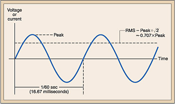

Q. I've heard and read about a multimeter capability called “peak capture” and a measurement called “crest factor.” I don't quite understand their importance or how they're used in a power quality site analysis. Can you explain?
DeDad's answer: As you know, electric utilities generate various voltages of electricity at 60 Hz that results in a sine wave waveform. The height, or amplitude, of this sine wave is called its “peak value.” Instead of using the peak value, however, we describe the amplitude of a sine wave as its effective, or root-mean-square (rms), value. As shown in the Figure above, the rms value of a pure, undistorted sine wave is about 71% (0.707) of its peak value.
The term “crest factor” describes the ratio of the peak value of a measured waveform to its root mean square. So a pure, undistorted sine wave's crest factor would be 1 divided by 0.707, or 1.414.
This crest factor value will vary from 1.414 if the waveform is distorted, which results in a peak value different than that of a pure, undistorted sine wave. In other words, a good voltage sine wave will have a peak value that's close to 1.414 times its true rms value.
This is where the “peak capture” capability of a multimeter comes into play. Basically, you would compare the theoretical peak value with what you measured using the peak capture feature. For example, let's suppose you're measuring voltage on a 120V circuit. Theoretically, the peak value of this voltage waveform would be 120V times 1.414, or 169.7V. A measured voltage peak, using the peak capture feature, that's significantly higher than this is an indication of the presence of harmonics.
