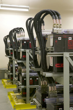

Used as an “insurance policy” for a mission-critical facility, UPSs provide continuous power during events such as transients, electromagnetic interference, and power failures.
The static UPS may provide conditioned power via double-conversion technology, where AC power is converted to DC power and then back to AC power. Or, by using a line-interactive UPS, power can be provided through an inline inductor (choke) with either a battery or flywheel to provide ride-through in the event of power loss or out of tolerance voltage. The disadvantage is that the line-interactive UPS cannot provide frequency regulation as compared to double-conversion UPS technology. The line-interactive UPSs, however, are typically more energy efficient compared to similarly rated double-conversion UPSs. Static UPS systems are used in most modern data centers and other facilities with equipment that requires continuous power. Typically cheaper than rotary units, static systems work best when smaller, modular systems are required for backup power.
When choosing a UPS, electrical engineers must also consider the system's storage device. Rotary UPSs may use flywheels or batteries, while static systems typically use batteries. Depending on the size of the UPS and de-rating of the UPS module, the flywheel can provide backup time anywhere from 12 seconds to several minutes. Battery-based systems should be used for projects that require an extended run time of conditioned power beyond the few minutes that a flywheel can provide. The battery can provide backup power to the critical load for hours, if necessary, but with a longer runtime for a battery reserve, the cost of the UPS is increased. Careful consideration should be given if the backup battery is used for an extended length of time, especially when used with high-density IT equipment. Without continuous cooling flow, the power delivered to the IT equipment via the UPS may cause thermal runaway and shut down the IT equipment.
Although they provide larger amounts of power in order to cover an extended outage, batteries have several disadvantages to consider. They typically require equal, if not more, maintenance than a flywheel system. Without this maintenance, batteries will fail prematurely. In addition, they typically require more space for installation. Another consideration is battery storage, disposal, and maintenance. Because large quantities of batteries are necessary for facilities with continuous power requirements, the disposal of spent acids could also be in the hundreds of gallons.
Flywheels, which can be designed either external or internal to the UPS unit, rely on kinetic energy to generate electricity — rotational energy is converted to electrical power. Flywheels are appropriate for use with a UPS unit because they provide sufficient run time to allow generators to start. However, they cannot provide cost-effective ride-through backup power at the same level as batteries. One consideration for flywheel usage is to ensure the ability of the unit to regulate power during discharge and recharge of the flywheel. The flywheel provides power to the UPS during an outage, but needs power to recharge itself when utility or generator power is available.
