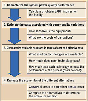

The economic evaluation procedure. The various technologies for improving power quality must be evaluated in terms of cost and the expected performance improvements they can provide. The improved performance is translated into economic benefits, based on the expected costs associated with the power quality variations. With the costs of the different technologies and the expected benefits, you can compare the different technologies to determine which one will yield the best return on investment, which is defined by the lowest total costs, including the costs of the power quality problems plus the costs of the investment required to improve the quality of power.
This process consists of the following four steps, which can also be demonstrated by the flow chart in Fig. 1 above:

Step 4: Find the best solution. The process of comparing the different alternatives for improving performance involves determining the total annual cost for each alternative, including both the costs associated with the power quality variations (remember, the solutions don't typically eliminate these costs completely) and the annualized costs of implementing the solution. The objective is to minimize these annual costs, which are the combined power quality costs and solution costs.
Comparing the different power quality improvement alternatives in terms of their total annual costs can help you zero in on the options that warrant more detailed investigations. You generally include the “do nothing” solution in the comparative analysis, and you typically identify it as the “base case.” The “do nothing” solution has a zero annual power quality solution cost but has the highest annual power quality costs.
Many of the costs (power quality, overhead, and maintenance) are, by their nature, annual costs. The costs associated with purchasing and installing various solution technologies are one-time up-front costs that you can annualize using an appropriate interest rate and assumed lifetime or evaluation period.
You calculate the power quality costs associated with the base case and the solution cases by determining the expected number of events that will affect the plant in each case. For each solution, you calculate the expected improvement in performance, and the power quality costs are reduced accordingly. Electrical power quality disturbances can have significant economic consequences for many different types of facilities. A wide variety of solution technologies exist for mitigating the consequences of such disturbances, and an economic evaluation of the range of alternatives can help identify the best option for a facility.
