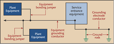

What does bonding do? As stated in NEC Art. 100, bonding establishes "an electrically conductive path that will ensure electrical conductivity and the capacity to conduct safely any current likely to be imposed." How does bonding do this? By permanently joining all metallic parts of a power-distribution system with a bonding jumper. You use the equipment-grounding conductor to complete the chain of bonding conductors.
As you can see in Fig. 1 (right), bonding jumpers tie the grounding system together through a reliable low-impedance path. If you remove an equipment-bonding jumper, that equipment no longer has a low-impedance path to ground. If you remove the equipment grounding conductor at the service entrance, no equipment has a low-impedance path to ground.
What happens if your path is unreliable, or the impedance is high? We know electricity prefers the path of least resistance. So, if your path to ground is a high-resistance path, where do you think undesirable current will primarily flow? Not into ground, because equipment and people are paths of lesser resistance.
Do you need uniform resistances? We know the relationship of resistance to voltage from Ohm's Law. Thus, we know if you have different resistances to ground from one piece of equipment or structure to another, you have a difference in voltage, too. That difference in potential could easily render the equipment unsafe because of the potential for electrical shock. If a person makes contact between two objects having different voltage potentials, current will flow through the person.

What if you configure your grounding system as shown in Fig. 2 (right)? This common configuration has problems. First, you already know the resistance between the two electrodes (connected only by the earth) is neither low nor reliably consistent. This means you have a high potential between the two ground rods. That freestanding electrode, though buried in earth, is not grounded. As electricity seeks the path of least resistance, it will seek a path other than the earth bonding jumper between that freestanding rod and the service-entrance ground rod. Because of the high resistance in your earth bonding jumper, that electricity will build up potential before it can start to flow. Instead of the volt or two you'd have on your copper wire, you may have several hundred volts of difference building up and suddenly discharging through equipment or people. So, you can see the grounding arrangement in Fig. 2 is unsafe. However, it would be safe if you bonded the two electrodes with a copper wire. Does that bond cause other problems that justify the safety risk of not having it?
Sin of omission. According to one myth, bonding those two electrodes allows undesirable current to flow from the main grounding system into equipment we must protect from undesirable current. This misconception describes deliberate omission of a bonding jumper as an isolated ground, which is incorrect. Fig. 3 (right) shows a properly configured "isolated ground." Notice how similar it is to Fig. 2. All we did to fix Fig. 2 was bond that isolated rod to the grounding system.
Think of an isolated grounding conductor as a directly wired bonding jumper, not a separate grounding system. Rather than bond this conductor to the equipment-grounding conductor or the building frame at the point of use, you run it to a point much farther upstream - usually to the service entrance. And you bond to ground there. Not bonding this isolated grounding conductor to the service grounding electrode results in a voltage potential between it and your grounding system. That potential could be lethal.
