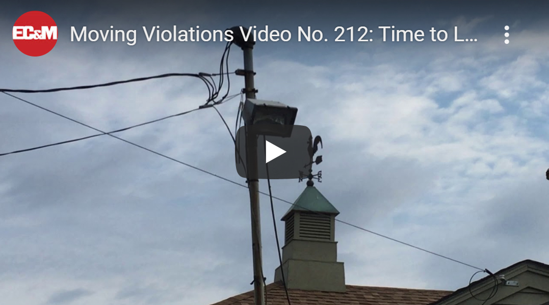

Moving Violations Video No. 212: Time to Lighten the Load
Russ stopped to take a closer look at this service mast when he noticed it had a slight lean. Upon closer examination, he identified the source of the problem. Someone violated the requirements of Sec. 230.28 by attaching this luminaire to the mast.
