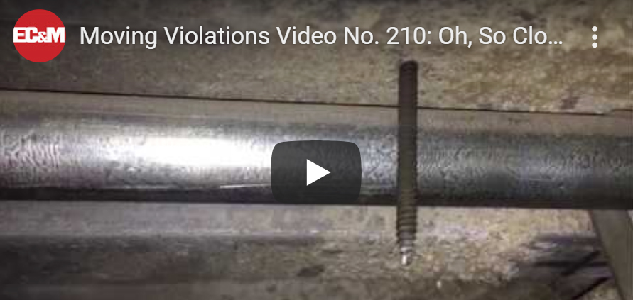

Russ found this near miss while working in the recessed ceiling space of a building. As you can see in the video, a roofing screw just missed penetrating an electrical metallic tubing (EMT) raceway because someone didn’t install it per the requirements of Sec. 300.4(E).
