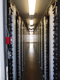

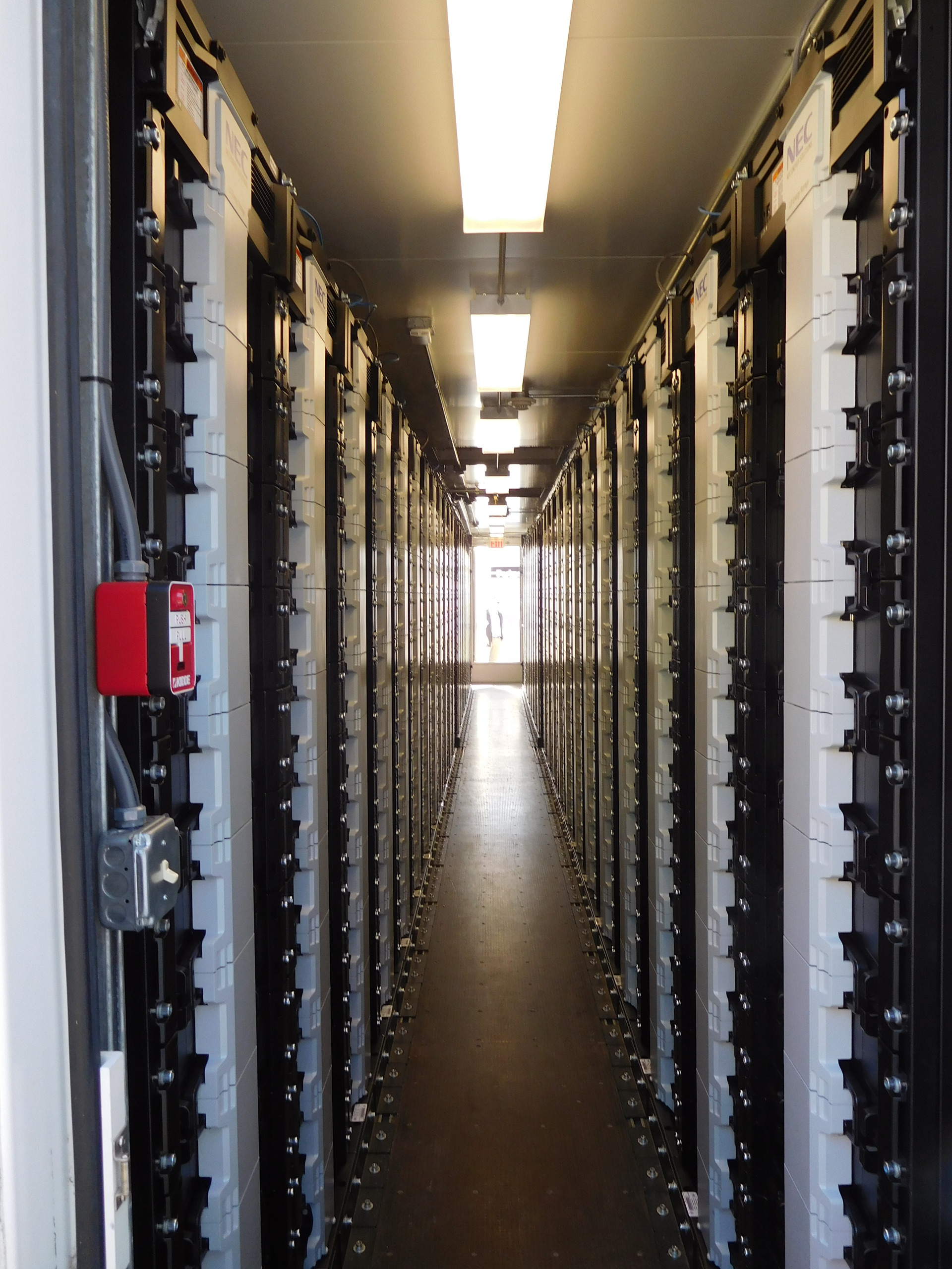

This new standard covers ESS installations in indoor and outdoor locations and provides even more installation restrictions when installing an ESS in or at a dwelling occupancy. Indoor locations include non-dedicated-use buildings or (put another way) general-use buildings that have an ESS installed within them. There are requirements for separation from adjacent ESS assemblies and a limit of 50kWh per group assembly. Dedicated-use buildings are those that are intended for use only for containing ESS assemblies for grid-tied operations. Information is provided for what else is required, which includes items such as site access providing a means for personnel to egress from the area and limiting such personnel to those necessary to operate the installation. This adjacent use is limited to 10% of the building area.
