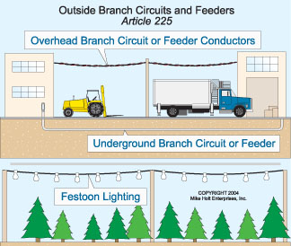

Article 225 provides installation requirements for outside branch circuits and feeders that run on (or between) structures or poles (Fig. 1). The NEC differentiates between buildings and structures, but for convenience we'll refer to both of them as structures.

For overhead conductors of 600V or less, maintain the following clearances: [225.18]:
  • 10 feet above finished grade, sidewalks, platforms, or projections from which they might be accessible to pedestrians if circuits are 150V to ground or less. Article 225 doesn't provide a clearance for over 150V.
  • 12 feet above residential property and driveways, and commercial areas not subject to truck traffic if circuits of 300V to ground or less. It's 15 feet for circuits over 300V to ground.
  • 18 feet over public traffic ways, parking areas subject to truck traffic, driveways on other than residential property, and other areas traversed by vehicles (e.g., those used for cultivation, grazing, or forestry).
