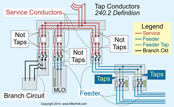

Fig. 2. Tap conductors are defined as conductors, other than service conductors, that have overcurrent protection ahead of the point of supply that exceeds the value permitted for similar conductors.

Feeders bring another twist to conductor sizing: feeder tap rules. A tap is a conductor (other than a service conductor) with overcurrent protection rated higher than normally allowed in Sec. 240.2 (Fig. 2).

You can run feeder taps without overcurrent protection (at the tap location), up to 10 ft (Fig. 3). But only if the ampacity of the tap conductor is at least the:
1. Calculated load per Art. 220, and
2. Rating of the device or OCPD supplied by the tap conductors.
Also, the tap conductors must:
1. Not extend beyond the equipment they supply.
2. Be in a raceway, if they leave the enclosure.
3. Have an ampacity at least one-tenth of the rating of the OCPD that protects the feeder.
