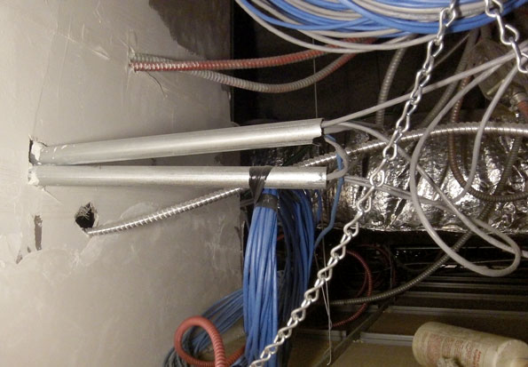

Sleeve Me Alone
The most significant safety concern here is the lack of firestopping around the MC cable and EMT where it has penetrated this fire-rated wall. Section 300.21 requires electrical penetrations through or into fire-rated walls, floors, or ceilings to be firestopped using approved methods in order to maintain the fire resistance rating of the assembly. No firestopping was used in this installation. The Informational Note for this Section provides guidance on where to find more information about maintaining the fire-resistive rating for various assemblies, including building codes and construction material directories.
The next violation I can cite is the coil of communication cable that is taped to one of the EMT sleeves. This is a violation of Sec. 800.133(B), which prohibits communication cables from being “strapped, taped, or attached by any means to the exterior of any raceway as a means of support.”
In addition, if you focus on the background of the photo, you’ll see several MC cables and a box that are not properly supported. Section 330.30(B) generally requires MC cable to be secured at intervals not exceeding 6 ft. MC cables of 10 AWG and smaller must be secured within 12 in. of each box. Boxes must also be supported in accordance with the requirements of Sec. 314.23.
