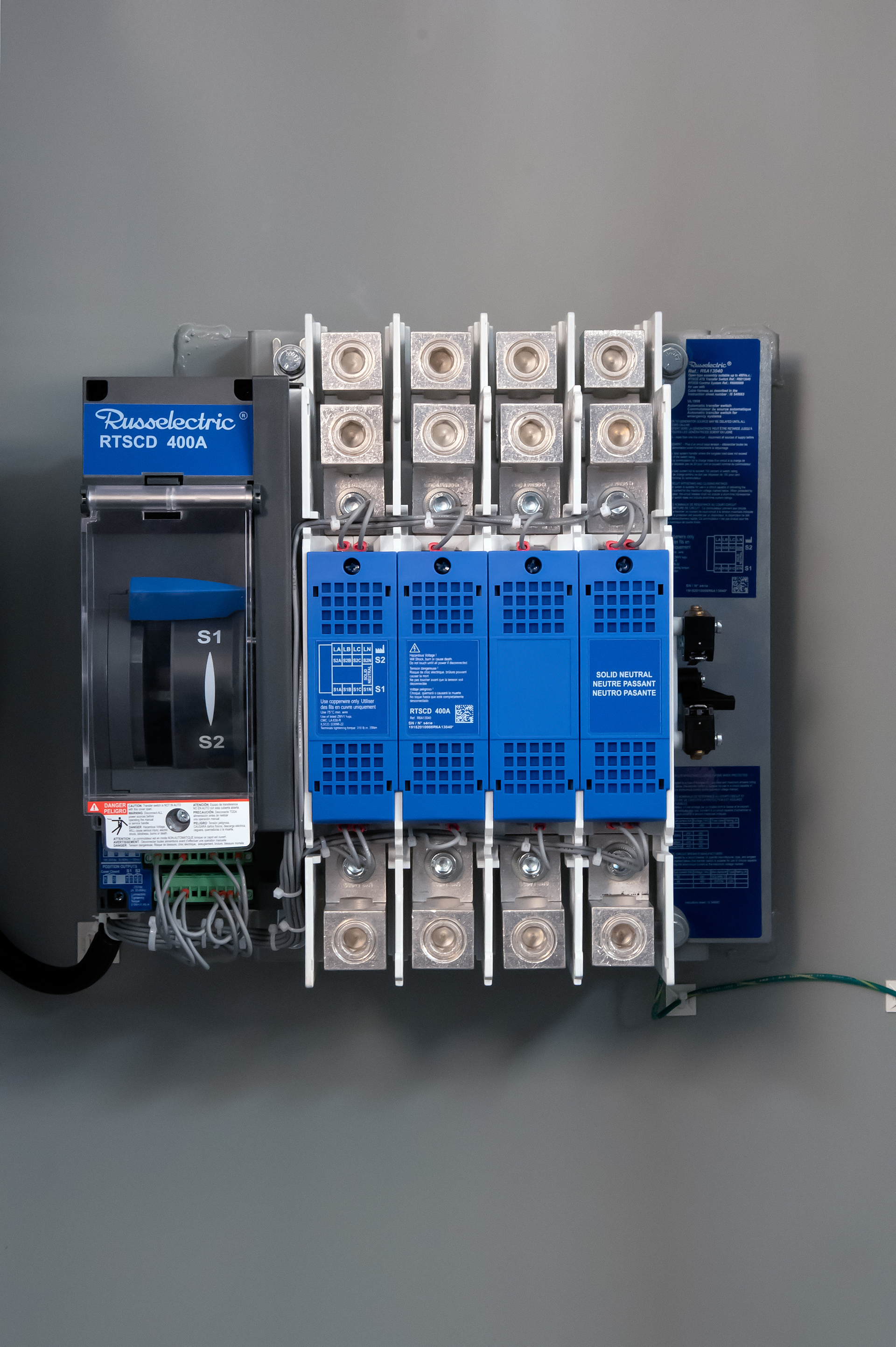

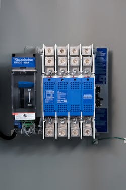

The RTSCD commercial-duty transfer switch from Russelectric, A Siemens Business, is currently available in 100A-, 200A-, 260A-, and 400A-rated models. Available in 2-, 3-, and 4-pole models, with solid or fully rated switched neutral, the front-connected RTSCD offers manual transfer with rapid arc interruption as well as a permanently affixed handle and double throw mechanically held contactor. According to the company, the unique design instantaneously opens and closes the contacts, providing rapid full arc interruption (even under maximum voltage and amperage) and considerably reducing erosion and effectively increasing the switch’s useful life. The product meets UL1008 up to 480 (VAC), and complies with NFPA 110, NEC Articles 700, 701, 702, Enclosure UL Type 1 and IBC 2018 and CBC2019 seismic standards. Optional accessories include a power monitoring package, auto/load test key switch and load shed relay, selector switch for auto/manual, pushbuttons for manual transfer, and a space heater/thermostat.
