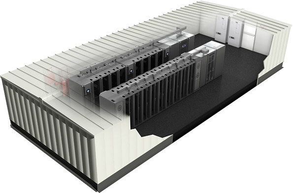

What exactly is a modular data center (MDC)? The NEC definition [646.2] is short (see NEC Defines Modular Data Center). For our purposes, think of it as a “data center in a box.” It’s a box large enough to contain information technology (IT) equipment racks yet small enough to be moved by road to a site. It’s not built in place, as is the traditional data center, but is shipped to the location.
Because of its relatively small unit size, the MDC has scalability and lead time advantages over its traditional counterpart. These two advantages combine to permit “just in time” deployment, so capital can be invested close to the actual need. From a corporate executive’s viewpoint, this makes cash flow look good; that’s one big reason MDC sales have been on a fairly steep upward trajectory.
Modular data centers can be deployed in weeks, versus months, for a conventional build-out. Installation costs can be reduced by averting expansion of an existing data center or construction of a new data center (rendering courtesy of Emerson Network Power).
An MDC is designed to be as self-contained as possible. But it’s not the case that you wheel it up and plug it in. The installation is more complicated than that, thus leading to the need for an NEC Article addressing the minimum requirements.
