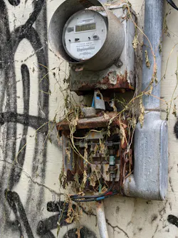

An EC&M reader who wishes to remain anonymous sent in this photo. “I found this weathered meter installation that I believe is feeding some DOT lighting and still energized,” he said. “It was next to a sidewalk but behind a fence just out of public reach.”
I think the term “weathered” is a bit generous. The service disconnect switch is completely rusted out, leaving the energized parts dangerously exposed. Although this enclosure may have complied with the rules in Sec. 110.27 for guarding live parts against accidental contact when first installed, it certainly does not comply now. Severe corrosion has taken hold of this equipment and is not letting go. Section 300.6 requires equipment to be constructed of materials “suitable for the environment in which they are to be installed.” Using stainless steel or nonmetallic equipment would have been the better choice here. The severe corrosion has compromised many of the bonding and grounding requirements in Art. 250 for this equipment as well. Regardless, this installation is overdue for a complete replacement.
